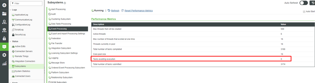

Hi @VladimirRosu_116627 ,
Thanks for the reply, found the issue, this is due to Subscriptions are taking more time to execute.
As per below pic, there were more than 1000+ task awaiting to be executed, that's the reason the subscriptions are not invoking or invoking late. The Tasks are pending because, our DataTables have more than 20,000 entries, querying them and applying the filters is causing delay in execution of services present in the Subscriptions.
Purging the DataTable Entries and restarting the Thingworx fixed this issue.

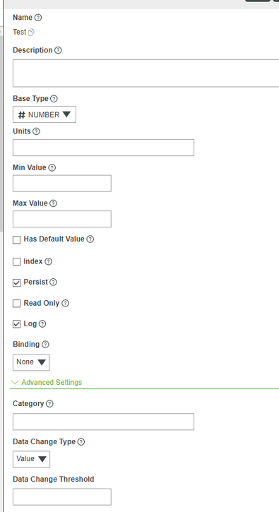

  • Thingworx version: 9.3.2
  • Number/String DataType Property, PFA:
  • I did put the Logger on the first line of subscription for testing, that's how got to know the subscriptions are not invoking.
    Shashi

There are a couple of things which are not obvious when you try to execute subscriptions.
First, if a property value has a timestamp older than the current property value, the *DataChange events will not be triggered. Instead, the HistoricalPropertyLogged event will be triggered.
Second, if a new property value comes in the system, and has timestamp >= the current property timestamp, and has the same value, then the *DataChange events will not be triggered if the DataChange type is set to "Value".
Both topics above are the default behavior of ThingWorx, and they are documented in the Help Center.
I do not know which of the ones above apply to you, but I can give you a potential situation when that might happen: when you have a large batch of properties that are sent to ThingWorx (either via EMS or via REST, through UpdatePropertyValues), due to the parallel nature of the threads in the Event Subsystem, you might write in ThingWorx a value with a newer timestamp before you wrote the older properties in the DataSet.
The solution in the scenario I explained is just to use both events (*DataChange and HistoricalPropertyLogged) and point them to the same processing service.
