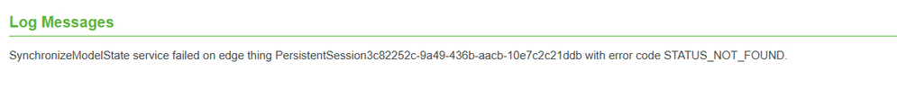

Hello All,
I am using GetProperties service from Dynamic ThingShpe, I have enabled automatic value update.
The properties which are being bind are set via service as it is calculated field (Not logged but persist). Thingworx version : 9.7
On page load I got warning in application log as below:
ApplicationLogApplicationLog
On Mashup log, below info shown:
MashupRuntimeLogMashupRuntimeLog
Any idea why I am getting this warning in application log, and how to avoid this.
Javed Akhtar
1 REPLY 1
This is expected: the AlwaysOn JS client in Mashup does not yet implement the SynchronizeModelState service. The platform will fall back to the legacy service if this one fails.
