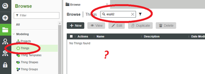

I'm using a Trial version for training, as it contains PTCDefaultProject, which has been encouraging good results in other trainings. However in developer training https://developer.thingworx.com/en/resources/guides/connect-adafruit-feather/run-arduino-demo in step 3, the tutorial asks to create a Thing called ESP8266, this thing contains abstractions for this microcontroller. In Set-03, apparently a PTC removed this thing from their base, according to the same. I would like guidance on how to proceed, in this situation, if it is possible to download a mod or even the Thing itself to continue the training. Or even if there are other training for the same microcontroller and or ESP32.

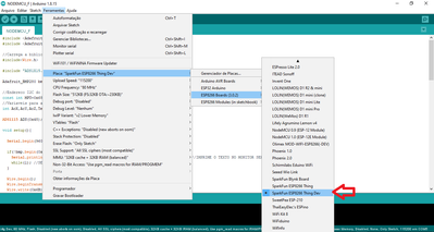

Hello @Telles ,
Did you successfully install the ESP8266 addon into Arduino IDE that has been mentioned in the step 1?

Hello, Bhawna.
  Yes, I got it!
  The problema is: where is the Thing called ESP8266, mentioned in step 3??

The MCU config sdon´t create a Thing in TX, the MCU just send INFORMATIONS to.
I installed the MCU Board, like printscreen follow since before start this post.
