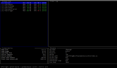

I have a setup with TWXFlow (8.5.4) on a unix Server (CentOS 8).
The installation of TWX Foundation was straight forward and it works.
But the TWX Flow app is, after a while, not responding in Browser.
And on the server itself 3 Flow Services have a very high CPU Load.
pm2 monit
There is only one Flow configured which does nothing (created flow and added 3 nodes, same behavior without any flows)
The logfiles show nothing for solving this problem. Are there any other troubleshooting possibilities to get flow running correctly?
EDIT: the Memory usage for the 3 Services grows upt to ~550 MB per Service
