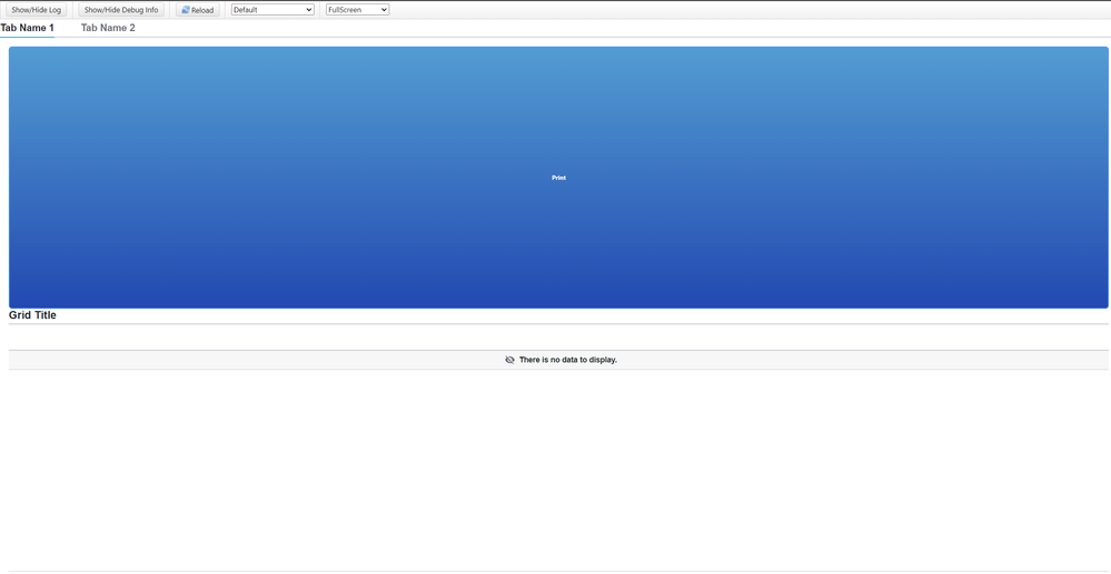

Hi @Hariharasuthan
Maybe this widget will be helpful for you.
I created this simple print button 2 years back. When you click on the print button (don't worry about button size it is a responsive widget ) it opens the browser print menu (simple Ctrl + P action) and you can save the page as a PDF file
If it is useful for you - Download Link
/VR
dear @Velkumar
   this is very usefully.  i  tried print button successfully came result ,   Thanks.

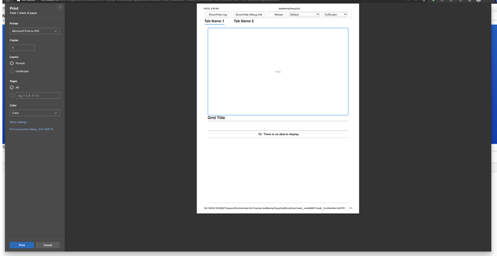

I think it's already visible in the screenshot above, but the output of the suggested Print functionality is not how the mashup will look for the end user.
Each browser applies print styles in the print window. As a result, the output PDF will not contain the mashup as the user sees it, but modified with less colors etc.
It may satisfy the end user, but it should also be verified that this solution is satisfactory.
I suggest using something like jsPDF, which will allow you to obtain a PDF that contains exactly what the user sees.
