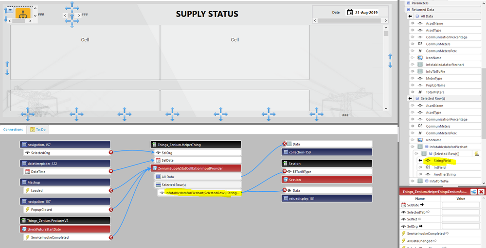

Can anyone please tell me how to pass selected data from thingworx collections to another mashup or widget..

Based on your screenshot it appears that you are already using session parameters which is what we would recommend.  You're passing the StringField to the EETariffType session parameter and you should be able to bind that parameter with any other widget or parameter in this or another mashup, within the same session.  Here is a link to some limited information on session parameters but it may be useful.

I have bonded session parameter to mashup parameter. Since I have used collections there is no value stored in Session parameter.  I tired printing session parameter value in label and text box, it returned nothing.

Hi @BhavyaPC ,
I had faced this issue and i had used the same concept session parameter but in my case the session parameters are replaced by a Thing's property.
Solution:
Create a Thing with Infotable property.
In the main mashup an event should trigger a service to set IT value to the created property.
In the child mashup you can retrieve the earlier set value .
This might not be a great workaround but its worth a try.
