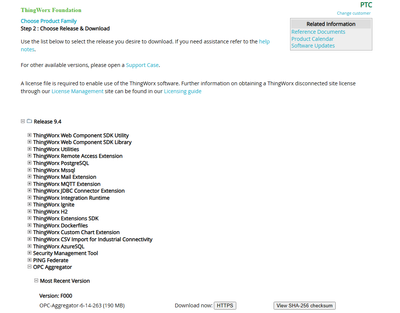

Is it possible to connect ThingWorx with PLC without using kepware?
If yes, what is the best way to do this?

Hi @RaulBernardo.PV
Based on my experience, once I used the MQTT extension to communicate with PLC ( which publishes data through MQTT )
If PLC has OPC Server configured. You can use Thingworx OPC Aggregator to connect with PLC
More information on OPC Aggregator :
https://www.ptc.com/en/support/article/CS279002
Article - CS321770 - Connectivity guidelines for ThingWorx OPC Aggregator (ptc.com)
https://www.ptc.com/en/support/article/CS307107
You can download OPC Aggregator from the PTC site under Thingworx Foundation family
