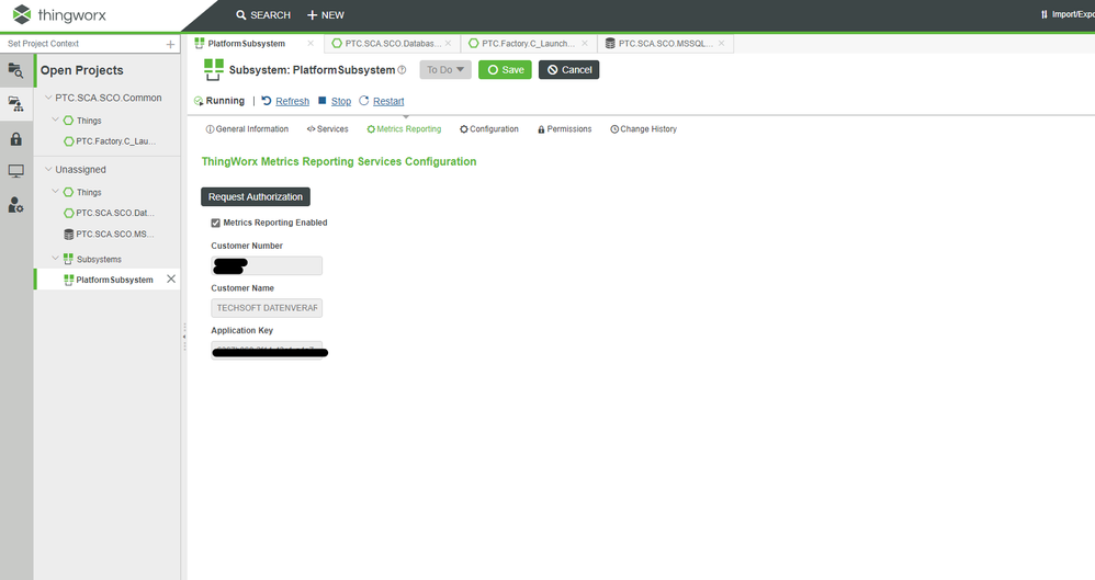

Thanks for this hint. But I have not been prompted to enter credentials as described in the article. When I enable the checkbox for Metrics Reporting I am not asked for any credentials.
Currently the configuration looks like this:
The customer number is filled. Also an application key is shown.

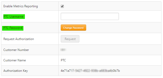

In the tutorial (https://www.ptc.com/en/support/article/CS262960) you can see that there is a possibility to enter PTC user account and password. In none of the ThingWorx installations available to me this is available.
Screenshot from the article:

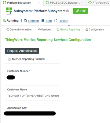

Screenshot from my ThingWorx instance:
As you can see there is no "PTC Username" and no "PTC Password" field.
Why are they missing?

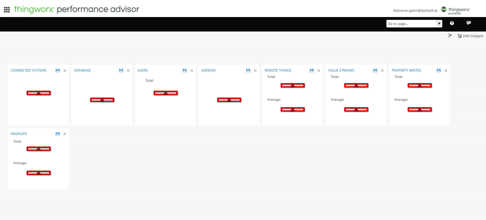

No. I am not able to enter my credentials since there are no input fields for PTC Username and PTC password. But I think that changed in recent versions of Thingworx. Those fields are not mentioned in the documentation of the platform subsystem either (see http://support.ptc.com/help/thingworx_hc/thingworx_8_hc/en/#page/ThingWorx%2FHelp%2FComposer%2FSystem%2FSubsystems%2FPlatformSubsystem.html ). So I still could not find out how to connect Thingworx to PTC Performance Advisor correctly. If I login to Performance Advisor I can see that no Thingworx server is connected. It looks like this:
