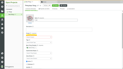

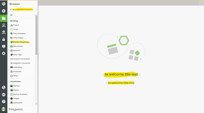

We have upgraded our Thingworx instance from 8.5.18 to 9.1.13 using Installer Upgrade.
After successful upgradation, we are getting few issues.  Please find the attached images,
  1. Mashups/Masters not able to view or edit
  2. Seeing additional menu item in Modeling menu
  3. Getting few labels with programmatic words.
    >> The additional item is the Project property which was optional and now becomes madantory since ThingWorx 9.0+.
    >> This is because the cache in your browser is not updated, you can fix it by clear your cache and access Composer again.
