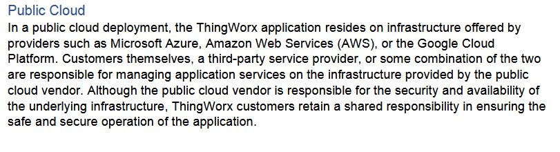

The only mention in the referenced docs I found is here, quote (article - "ThingWorx Secure Deployment Hub", link: https://www.ptc.com/en/support/article/CS318702

Thanks for your response @VladimirN.
So, if I understand correctly, Google cloud deployment is not officially supported by PTC but it is possible to deploy ThingWorx on Google cloud infra. Previous post is an older one and raised it again to know if there are any updates as part of new releases.
