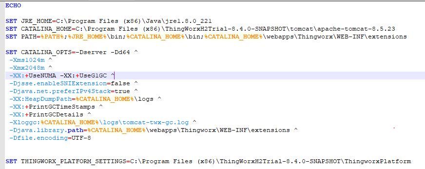

photo_environ_scan.JPGYes, you are right. It was upgrade yesterday but I didn't make the link between the two event due to the delay.
I add the path like you said but I still have the error did I miss something. I add the path on the environnement system. Path highlight on the capture.

I made some research and I found that on the setenv.bat the path are write.
So I check if something was wrong but it seems okay, the jre_home is link to my latest java version.
Does someone know why there are ~ are the path name ? Is this some kind of abreviation ?
Is there an another files that I should check for tomcat ?

Those "~" are artifacts of FAT16 filesystem, which only supported 8.3 filenames. Apparently Windows still maintains backward compatibility with MS DOS 6.22, which was deprecated 20 years ago. Pretty weird to see it in 2019, but...
I'd tried two things if I were you:
  1. Put full correct paths in that BAT file, like that:
    SET JRE_HOME=C:\Program Files\Java\jre1.8.0_221
    (do the same for CATALINA_HOME and THINGWORX_HOME as well)
  2. If that doesn't solve it -- why don't you just copy your JRE to something like "c:\jre8", replace the path in your BAT file and try again?
Also keep in mind that your PATH entry is incorrect, you need to remove "\server" from it.
For the future, installing all software in some simple directories like "c:\jre8" or "c:\twx" may save few nerve cells (use short lowercase alphanumeric names).

I went back and looked at the image you provided of setenv.bat with the updated path.  This variable does not have the correct path:
SET JRE_HOME=C:\PROGRA~1\Java\JRE18-1.0_2
The error log confirms this:  [2019-07-24 14:35:13] [error] [ 1536] Failed creating java C:\PROGRA~1\Java\JRE18~1.0_2\bin\server\jvm.dll
From one of your later screenshots, the folder containing the java upgrade appears to be ....\jre1.8.0_122.  You'll have to validate the full path when making your change as I'm not able to see that information.
