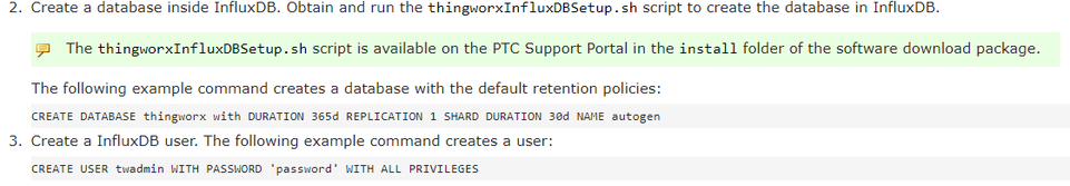

I'm currently trying to use InfluxDB 2.0 as a persistent provider with Thingworx 9.1.
I tried following the tutorials on the PTC support websites but they only explain how to set it up using InfluxDB 1.7 and 1.8.
I tried following those same steps documented there but i realized that the Data Base concept had changed in the 2.0 version of InfluxDB, which made it impossible to go on with the tutorial. As i started getting errors trying to execute CREATE DATABASE function.
Thank you in advance
1 ACCEPTED SOLUTION
InfluxDB 2.0 is not supported in ThingWorx 9.1
9.2 is due to release in a week or two, and InfluxDB 2.0 could be supported there, as far as I know.
Not exactly sure about it, though - I believe I've seen InfluxDB 2.0 in the list of the supported DBs for 9.2.0 in the release advisor a few weeks ago, but it's not there now.
