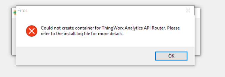

Hello everyone,
i have read all the other threads regarding this topic and so i tried to follow the pre installation steps mentioned here.
So i downgraded my docker version to 17.03.0 ce and my previous occuring "post installation error" does not come up any more. Instead i have the following errror
Attached you can find the log file. But the line where the error occures says:
2018/04/23 11:15:19 Post http://172.20.208.1:8080/Thingworx/Things/TW_ML_Configuration/Services/setConfiguration?method=post&Accept=text&userid=Administrator&password=trUf6yuz2?_Gub: dial tcp 172.20.208.1:8080: connectex: No connection could be made because the target machine actively refused it.
I have no idea how to set up this "target machine" to allow the connection.
Any help is appreciated very much.

Hi
The error you get is
" C:\Program Files\Docker\Docker\Resources\bin\docker.exe: Error response from daemon: oci runtime error: container_linux.go:247: starting container process caused "process_linux.go:359: container init caused \"rootfs_linux.go:54: mounting \\\"/C/Users/D76C5~1.RIE/TWX-AN~1/edge-config/analytics-server.properties\\\" to rootfs \\\"/var/lib/docker/overlay2/1b442ff0d9b69cd3a4306c7fa12e16545ab9a7c0d1ec27f5341c506a635103dc/merged\\\" at \\\"/var/lib/docker/overlay2/1b442ff0d9b69cd3a4306c7fa12e16545ab9a7c0d1ec27f5341c506a635103dc/merged/maven/analytics-server.properties\\\" caused \\\"not a directory\\\"\""
: Are you trying to mount a directory onto a file (or vice-versa)? Check if the specified host path exists and is the expected type."
This is an error than can be caused by several things.
You will want to checkthe following:
- Docker daemon is allocated 6Gb (the default is 2Gb) - on Docker for Windows, select the docker icon in system tray > right mouse button > Settings > Advanced
- The C: drive is not shared, similar as above in Settings > Shared drive make sure C: is selected
- restart docker
However, if you are installing Analytics Trial in order to execute https://developer.thingworx.com/resources/guides/operationalize-analytics-model . I would recommend that you hold on for now.
I need to double check the status of the installer available in the Developper Zone. From what I have seen, it would seem we need a newer version to include the ThingPredictor. I need to confirm that and will post back.
Thank you
Christophe
- restart docker
Thank you
Christophe
Its exactly like you said, im trying to redo the situation in your link.
Drive C is shared but memory allocated is 3.5 Gb. In the installation guide i believe this is not mentioned, maybe would be good to add that.
I just tried to increase the memory, but its not possible since my local machine has "only" 8GB Ram.
Anyway, thank you very much for your effort and patience!
