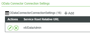

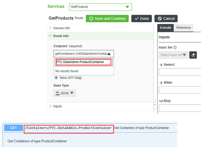

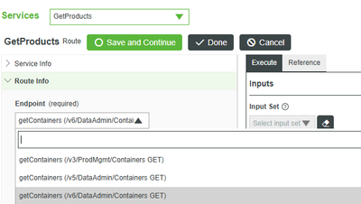

I have the v6/DataAdmin in OData Connector Connection Settings on the OdataConnector. I am able to see the getContainers API but I need to get list of Products, so I'm looking for this end point but it is not visible in thingworx connector.
/Windchill/servlet/odata/v6/DataAdmin/Containers/PTC.DataAdmin.ProductContainer
Hi @11025060,
You probably need to configure it manually to make the rest api available.
See article CS284781 How to enable Windchill REST Services endpoints in the OData Connector that are not automatically configured in ThingWorx
Tony
