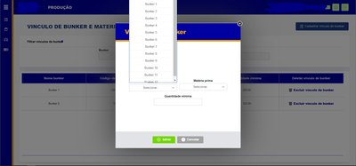

Hi!
I don´t know why, but in my popup mashup I have two dropdown widgets and when I click in one the information is showed on top of the dropdown box. I want the information under the box.
How can I fix it?
*my Thingworx version is 9.3.9
This problem was caused by the layout wrap, so I limited the items list height of the DropDown to fit in the mashup

Thank you for the support, but the data come from SQL, and is shown correctly. I just want to show the information under the DropDown box.
Is this article for this inssue?
