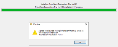

I have a freshly setup Windows Server 2016 Machine. I installed the newest JDK (13.0.2).
When running the installation Wizard, the installation ends with the message:
"A Problem occurred during installation that may cause an unsuccessful installation
foundation installation failed"
followed by the message:
"There has been an error
Thingworx Foundation trial for h2 installation failed. Please check the logs. The application will exit now"
Unfortunately I can not find any log files. I also can not try another installation since "There already is a Thingworx version installed".
When trying to uninstall the current version, it can not find the uninstall file...

Hi @dr1.
It looks like you missed the step in the instructions from the link you provided that indicates Java 8 is required:

You should use Java SE Development Kit 8,Update 141 or later, 1.8.0_141-bxx (64-bit)
https://www.ptc.com/en/support/refdoc/ThingWorx_Platform/8.5/ThingWorx_8_5_System_Requirements
Try to see if you have any Apache service installed and un-install it.

Hello @slangley,
thank you for your reply.
I first installed the java jre 1.8 as you can see here
When trying to start the installation, it asks me to add java to the PATH variable
But even after doing so I get this error message:
So I installed the Java JDK Version 13 (Version 8 is not available withouth Oracle Account), which shouldn't be a problem since the guide says Version 8 or above.
After installing the JDK I get the following message when starting the installation:
This time, when I add the bin folder to the Path variable, the installation finally proceeds, only to fail near the end:
Edit: I just setup an oracle account and downloaded JDK 8 and it works!

Hi @dr1.
Unfortunately, the error regarding the java version indicating 1.8.0_141 or above is misleading.  It's actually referring to the java 8 patch level.  At this time, only java 8 is supported
Glad to hear things are working now.
