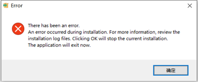

 I was unable to install ThingWorx Foundation 9.2.0. It crushed and give no clue why it cannot finished install.
The entire folder will be deleted even before I press Accept button. The log is attached below.
The java version is 11.0.12. JAVA_HOME = C:\Program Files\Java\jdk-11.0.12; Path: %JAVA_HOME%\bin

2) There are two lines of interest in the bitrock_installer_16884.log - the first one reports an error and the second one mentions the location of the additional log file. Is this log file available or gets deleted before you can get it? And can you attach / share the "C:\Program Files (x86)\ThingWorxFoundationH2Trial/ThingworxPlatform/platform-settings.json" file?
Error running C:\Program Files (x86)\ThingWorxFoundationH2Trial/installer/functions_files/json/read_json "-configfile=C:\Program Files (x86)\ThingWorxFoundationH2Trial/ThingworxPlatform/platform-settings.json" "-jsonpath=PlatformSettingsConfig.LicensingConnectionSettings.timeout": 2021/07/26 17:03:31 PlatformSettingsConfig.LicensingConnectionSettings.timeout does not exist
[18:03:31] Wait 560s for /\[[^\]]+Thingworx.war\][^\n]*\[[^\]]+\]/ in "C:\Program Files (x86)\ThingWorxFoundationH2Trial\tomcat\current\logs\thingworx-foundation-stderr.2021-07-26.log"
This seem to trigger aborting installation - the next line starts aborting installation
[18:07:36] Executing abort action : ccif_start_post component

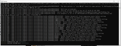

Is the Tomcat malfunction? I manually run startup.bat and the window last for a few minutes then closed. The screenshot below is captured the moment it ready to close. Is it normal? Or it shows other cause of install failure?
The license file is normally named "successful_license_capability_response.bin". License.bin used to work before, but I'm not sure about current status.
You can try to make a copy and name it "successful_license_capability_response.bin", just to test, but I wouldn't count on this.
The main source of startup information and issues is the ApplicationLog.log file in the ThingworxStorage\logs folder.
Check what's there and share it.
