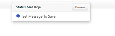

I'd like to ask your help on one of our requirements. At the compony we are working at there are many user requirements that is related to Keyboard Shortcuts usage.
Users would like to use Keyboard Combination to perform some tasks or interact with mashup services/functions.
For example, pressing F1 or CTRL+H on a specific mashup would open a 'Help' document for the user if mashup is active/loaded (considering master mashups also). (see attached img)
We are thinking about creating a custom extension widget, that would register an eventlistener for keyboard pressing, however it seems very complex not only to capture the keypressing, but also to fire a service/event binded to this widget.
e.g.: Widget would have property
if there user pressing the desired combination, the service / function is getting invoked.
I'm wondering whether there is any working solution to achive similar functionality on the Mashups.
Any help, suggestion how to achive the above is greatly appreciated!
(Current Thingworx version is 9.3.2)

Hi @VladimirRosu ,
We have defined the below event and with the above code we should be able to trigger it.
//ide.js
this.widgetEvents = function () {
    return {
        'KeyDownEvent': { 'description': 'Triggered whenever the user pressing a keyboard button.' }
}};the below was not working , the event was not fired when the mashup was opened (so afterRender is not trigggering the event in our case)
//runtime.js
this.afterRender = function () {
    var widgetElement = this;
    widgetElement.jqElement.triggerHandler('KeyDownEvent');    //triggering event defined in the ide.js
    TW.log.warn('After Render func finished');    //logging whether function is finished
In the runtime.js we specified:
-renderHtml (we are hiding the widget)
-afterRender (we placed here the code first, but was not working.)
-updateProperty (we are not updating any property as it will be just a static widget)
Testing afterwards by adding a listener to the widget runtime.js and adding the suggested triggerHandler is working as expected
The code in the runtime.js for the widget to the event.
document.addEventListener('keydown', function (event) {
    if ((event.ctrlKey) && event.key === 'h') {
        event.preventDefault(); // Prevent default browser behavior
        thisWidget.jqElement.triggerHandler('KeyDownEvent'); // Fire the ThingWorx event
result:
