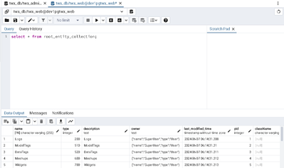

I am configuring Thingworx 9.5 in our linux box.
I have created twx_db database using the thingworxPostgresDBSetup.sh and thingworxPostgresSchemaSetup.sh. Databases are created successfully. And have used twx_web as the user for this database.
Am able to connect to this database using
Also am able to query root_entity_collection table:
But when I start my thingworx server, with below configuration.
But I get the error :
2024-06-07 07:40:16.522+0000 [L: ERROR] [O: E.c.q.l.c.Logger] [I: ] [U: SuperUser] [S: ] [P: twx0] [T: main] Configuration setting ContentTypeSettings.supportedMediaEntityContentTypes cannot be null
2024-06-07 07:40:21.945+0000 [L: ERROR] [O: E.c.q.l.c.Logger] [I: ] [U: SuperUser] [S: ] [P: twx0] [T: main] ERROR: relation "root_entity_collection" does not exist_ Position: 24
2024-06-07 07:40:21.945+0000 [L: ERROR] [O: E.c.q.l.c.Logger] [I: ] [U: SuperUser] [S: ] [P: twx0] [T: main] !!!!! Error loading model
2024-06-07 07:40:21.961+0000 [L: ERROR] [O: E.c.q.l.c.Logger] [I: ] [U: SuperUser] [S: ] [P: twx0] [T: main] *** CRITICAL ERROR ON STARTUP: ERROR: relation "root_entity_collection" does not exist_ Position: 24
2024-06-07 07:40:21.961+0000 [L: ERROR] [O: E.c.q.l.c.Logger] [I: ] [U: SuperUser] [S: ] [P: twx0] [T: main] *** Web Application STATE is being set to ERROR! ***
What am I missing here ?

Are you connecting to the right database (dev1pgtwx_web vs dev1pgtwx)?
Could also be a namespace thing with RDS. Try to remove currentschema, or put it as a default to the user in PG.
There are also multiple articles on PTC support and in the community on "relation root_entity_collection does not exist":
