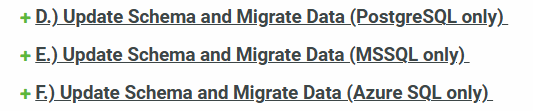

I am on Thingowrx 9.0 for a project. We need to upgrade to PTC ThingWorx 9.7. I have performed numerous Postgres SQL upgrades, but not with MS SQL. I've been trying to find an article through the Knowledge Base, and the proper steps are nowhere to be found.
Thingworx Version: 9.0
Azure MS SQL: V12
Solved! Go to Solution.
Hi @pshashipreetham,
The upgrade procedure for ThingWorx almost remains the same, regardless of whether you are using Postgres or Azure SQL as the persistent provider/DB.
To upgrade ThingWorx 9.0 to 9.7, you need to find an intermediate version to upgrade to first like 9.3 by looking at the supported upgrade path table in the Help Center below:
The only major difference is when you do upgrade, you refer to the different section (run difference script) to upgrade DB schema and migrate data
