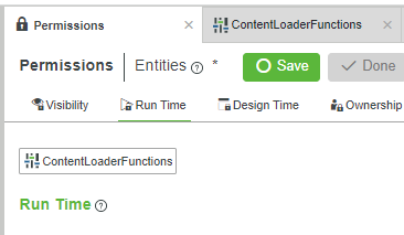

When I run Resources["ContentLoaderFunctions"].GetJSON(params) when I logged in as a developer, the data is returned.
When the user on the floor logs in and runs the page then get an error  [content loader functions] does not exist].
Why does it exist for me as the developer and now for the user on the floor?
  • "not found" always means visibility permission is missing for the user.
  • not authorized for serviceInvoke, propertyRead.. means runtime permissions are missing
Like jensc mentioned last you need to add visibility permission to the entity (which only works with organization(units)). Or what Sharon mentioned if you don't want to allow the user itself, you can do it via System user.

Have you made sure that the user has the correct permissions to use the service?
Go to the "ContentLoaderFunctions" resource and hit the "permissions" tab and check under runtime:
Here your user or their group should have access.

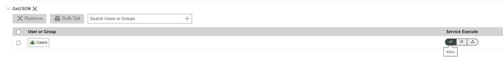

You could also give them access to everything like this:
But I wouldn't recommend it.
You might also give them visibility permissions through an organization.

Thanks for the reply. I have added the user group with this user to the permissions and allowed service execute and still does not display to the user.
