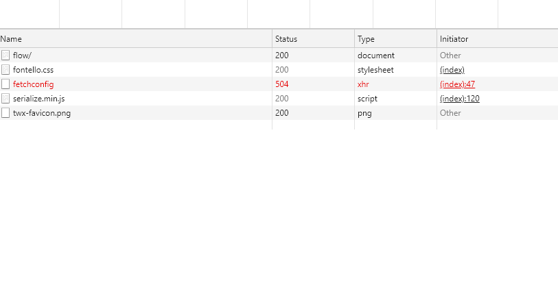

I have installed thingworx and flow in my machine (win 10), able to access thingworx and  workflow subsystem is shown as running, but when trying to access workflow composer getting blank screen(accessing via https and hostname ).
I;m using thingworx and flow 8.5.6
I can see 504 for enterprise/v1/fetchconfig enterprise/v1/fetchconfigUntitled.png
Issue got solved , issue was because of residue of a failed flow installation and system firewall was blocking the thingworx flow service to start.
steps followed
1. removed residue from failed installation by steps mentioned in  link  though it is for 9+ version It kind of worked for me (I'm sing 8.5)
2. reinstalled after disabling firewall
note : I was using hostname:port for assessing the flow composer.

Hi @TT_9604451.
What url are you using to access Flow?  You need to be sure to use the hostname and port you indicated during the installation process.
steps followed
