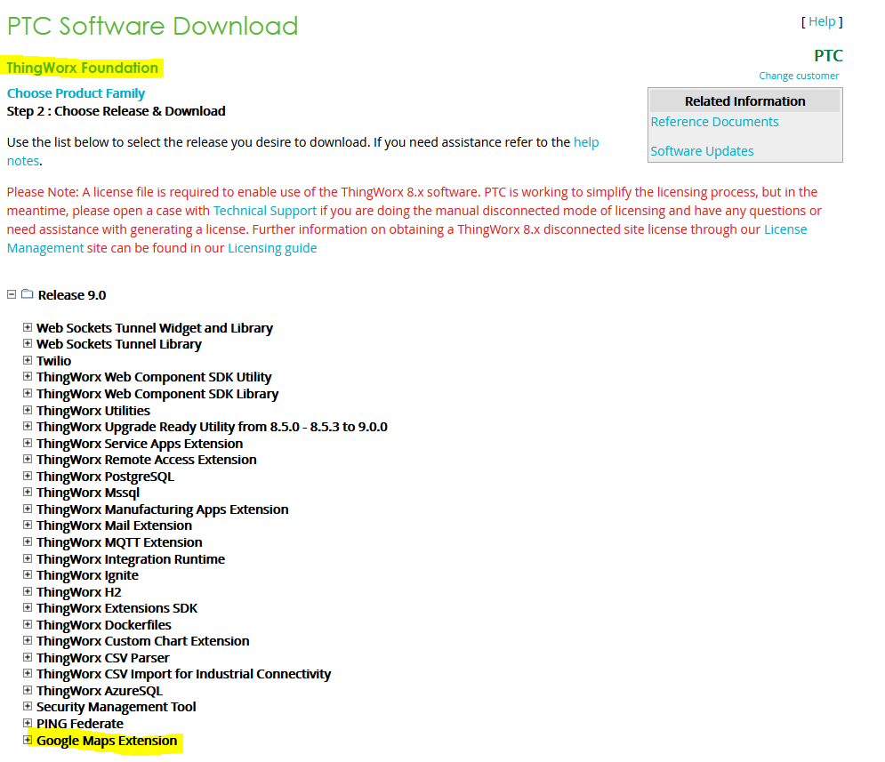

Hi everyone.
The updated Google Maps widget is now available.  It is no longer available on the PTC Marketplace.  Instead, you can download it from the PTC Support site under each of the 3 versions available:
This version is compatible with ThingWorx 8.2 and above.

Hi everyone.
Regards.
