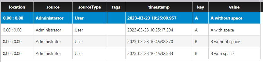

tried with following, and it's working fine.
  • ThingWorx 9.3.7-b1432
  • PostgreSQL 14.3
  • AddDataTableEntry() - "A" records (Manual entry)
  • AddDataTableEntries() - "B" records (Manual entry)
That's strange!

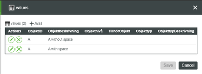

When using the AddDataTableEntries() manually where "ObjektID" is the key:
As you can see, it does insert the first row but fails when trying to insert the second.
This data comes from an upstream system and they say this values should be unique (which it is I guess), but some users had accidentally added a space after the value and then recreated without it without removing the "bad" value.
