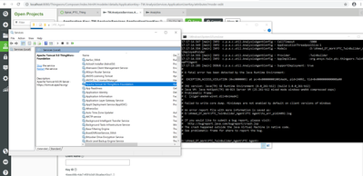

Hello All,
I was using the cloud version of thingworx, and now moved to local installation.
In the cloud one, I used to start my work by running an agent file with the URL address of my account such as below:
URI=wss://PP-2007161840G0.devportal.ptc.io:8443/Thingworx/WS
and add the APP KEY.
Now I know how to get the APPKey but not sure how to use as URI for the local installation.
Should I use: URI =http://localhost:8080/Thingworx ??
Best,
Ahmed
8 REPLIES 8
I tried to use the URI as below,  but I got the fetal error attached. Any idea?
URI=http://localhost:8443/Thingworx
I am attaching the error log file

Hi @Ghandour.
Please provide the logs located at \ThingworxStorage\logs.  These should provide more information regarding whether ThingWorx is running successfully.  If there are no logs at that location, please provide the following:
  • <tomcat_home>\logs
  • platform-settings.json located at \ThingworxPlatform

Hi @bot1q
I am not sure, how can I check that?
Hi @bot1q
Is that what you mean? if yes, then I have it and it is runnung but still same issue

Hi @Ghandour.
It appears there is a problem with java.  You have installed a supported version, but given the errors it's returning, there may be some corruption.
When you initially installed it, were you using an Administrator account?
Please also provide some details regarding your environment.
  • What version of Windows are you running?
  • Is it 64-bit?
  • Did you install the JDK or just the JRE?
  • How did you install the product?  Manually or with the installer?  What was the filename if the installer was used?
