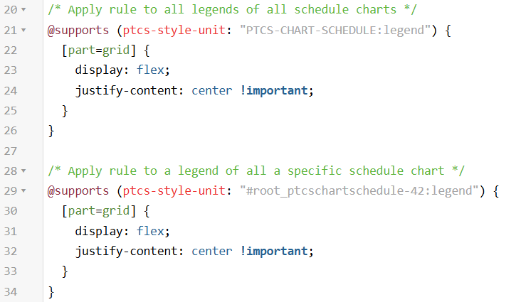

I received an answer from the Subject Matter Expert. I have added the information to Article - CS439465 - ThingWorx Web Components Customization with CSS
For convince I am placing the code here as well.
Please review and test. If it meets your requirements place mark the solution.
