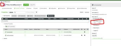

Hey hey Community,
I have following scenario.
I have Thingworx Foundation 8.5 (Trial), Imported MQTT Extension and have already created a,
new thing called "VerneMQconnect", as MQTT Connect,
new thing called "VerneMQsubscribe", as MQTT Subscriber
But the Problem is that the VerneMQconnect always show "Disconnected"
 and "isConnected" never turn "True" it's always "False".
There is no firewall issue or somthing like that. I have tested the MQTT Broker in different ways ant it always worked without problems. Except in Thingworx, here it doesn't even manage to connect to the Broker. The Error Log schows:
This is a bug. I am assuming you are using v2.1.0 of the MQTT extension. When using v2.1.0 & ThingWorx 8.5 isConnected and lastConnection properties are not updated. Publishing and subscribing properties works fine. v2.1.0 also works fine on 8.4.
This has been fixed in MQTT Extension v2.1.1.
Unfortunately, i forgot to attach the Picture.

sSame issue.
It never shows 'connected' when using Thingworx 8.5 Trial verision and it is actually connected cos the property is updated.
But a big issue is that the Thing Entity fails to reconnect after the MQTT broker restarts.

thanks a lot for this hint. I have searched for a long Time to find out which Version I have and than found this information in the Metadata itself and u are absolutely right that i have included the Version 2.1.0. Unfortunately i need to say that every Guide and Documentation links to the older Version of it...
I will now include the new Version and will let u know later whether this is the solution.
Franz93
3-Newcomer
(To:rjanardan)
Many Thanks for your Support.
I decided to completely reinstall the Tingworx Foundation and after that import the MQTT Extension v2.1.1. Now its working.
Hi, rjanardan. Thank you so much for your answer. It works after I upgrade the extension to the new version.
