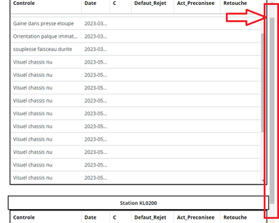

When using a collection widget within a mashup, as the data used for collection widget is more so the page is getting vertical scroll bar within the collection widget area. I want to disable the vertical scrollbar and instead scroll the page. This can be seen as:
In the container (where the collection widget is placed under), the "Container Scrolling -> vertical" is Disabled and can't be edited. And similarly in Container properties "EnableExpandCollapse" property seems to be un-editable, as seen in the below screenshot.
In one of the community post, this issue was addressed / fixed in ThingWorx v9.3. However, though I'm using ThingWorx v9.3.5, I'm not able to fix this, please let me know I'm missing out anything.

@pshashipreetham - The issue is not with the "ExpandCollapse" property, but with Collection mashup.
The data that is being passed to the Collection widget, when viewed, the data rows are more than the height of the container area. And so, the container area gets scrolled instead of the entire page. This functionality creates an issue while taking a print i.e., with container being scrolled, the print page trims the rows in the lower section.
If we do not have container area scrolling, and instead having the page to scroll, will enable us to take a print with all the rows (in multiple pages)

@slangley you are referring to the article which mentions about the "Container" scrolling. In my case, the issue is with scrollbar in the Collection widget.
It's not that weird what is happening. You have a fixed size for the collection cells so it will create a scroll within.
Collection cells don't affect the container that the widget is in. Cells are positioned absolute and they "recycle" and reused as you scroll for cases where there are a lot of rows and having all that DOM in the browser would cause low performance.
It can be done, but not with OOTB. You might want to check out BMCoreUI widgets which is open source widget pack and has a more advanced Collection View widget and a TypeScript widget with which you can alter the layout of the Collection View cells. And it can't be easily done.
