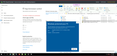

Goodmorning.
I am following this guide to build a Predictive Analytics Model Guide: https://community.ptc.com/t5/IoT-Tips/Build-a-Predictive-Analytics-Model-Guide-Part-1/ta-p/810137
The goal is to complete the "Global System Integrator Program" for the company I work for,
I created a Virtual Machine in PTC Cloud Portal and I created an environment just for training.
Environment info: ThingWorx 9.3.6 for TE Training-Windows 2019 by Satish Lovevanshi.
I followed the installation guide.
I saw that there is a separate instance of Analytics Server to be added.
I downloaded the installation files in the VM, but I can't run the .exe file because the Windows antivirus blocks it. Even if I am the Admin, I can't disable it or even whitelist it.
Has anyone experienced something similar or have any suggestions in general?
P.S.
Me and my team already have a RockWell partner to ask, and he suggested to come here because he didn't know how to help us.
Thanks in advance.

Hi @VA_10934394
This appear to be some constraint at VM/Cloud portal level rather than with ThingWorx Analytics.
In that case it is best to contact the Cloud portal team, see https://www.ptc.com/en/support/article/CS329973 for that.

I don't think you are supposed to install additional server software on those images for security reasons.
You should take an image which already contains the Analytics Server.
But as @cmorfin said, a ticket with the Portal support team is the way to go.
