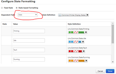

I tried to bind colorformats dynamically on pie chart from an infotable service output . But colors are not applied on pie chart.Please find the attached screenshots.Let me know where It went wrong.Thanks in advance

Is the answer that your info table should return something more like
PropertyName: SegmentName (e.g. "MS" or "CUB")
PropertyValue : 300 (some integer value)
Then you need a state definition tied to the 'PropertyName' parameter to give you the colour you requiire.
We use the pie chart for a similar thing and our infotable looks like this
We then have a state definition like the below which is tied to the 'State' parameter:
so rather than your infotable having a column for each type ("MS", "CUB" etc.) you have an infotable with one column for the type parameter and return a number of rows .
The pie chart is then bound to All Data from infotable service and the pie chart settings are set accordingly. In our case:
