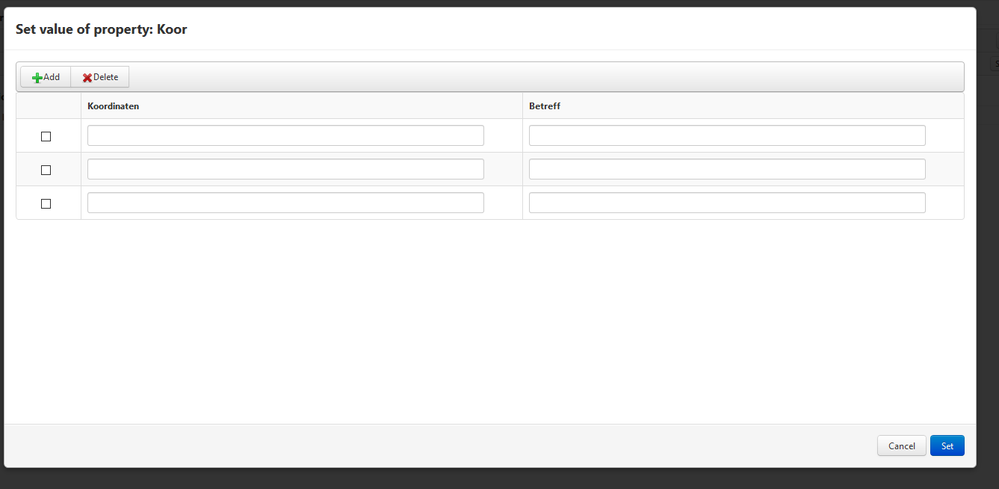

Hello Community,
I hope my English is sufficient to explain my Problem.
I developed an App in Unity to transfer Data/Information about Test Parts for my Masterthesis and I am nearly finished.
I have only one Problem to transfer Data from my Unity App to our ThingWorx Server.
I wrote an Service to transfer my Data to my Info Table:
ServiceCode:
var koorDaten = new Object();
koorDaten.Koordinaten = objektkoor;
koorDaten.Betreff = objektbetreff;
var tablereference = me.Koor;
tablereference.AddRow(koorDaten);
Code in Unity
                string myPostData = "{\"objektKoor\":\"" + 444545 + "\", \"objektBetreff\":\"" + 1333 + "\"}";
byte[] pData = Encoding.ASCII.GetBytes(myPostData.ToCharArray()); Debug.Log(pData); string auswertung = Encoding.ASCII.GetString(pData); Debug.Log(auswertung); Debug.Log(System.BitConverter.ToString(pData).Replace("-", string.Empty).ToLower()); Dictionary<string, string> dictionary = new Dictionary<string, string>(); dictionary.Add("cache-control", "no-cache"); dictionary.Add("appkey", "xxxxxxxxxxxxxxxxxxxxxxxxxxxxxxxx"); dictionary.Add("content-type", "application/json"); dictionary.Add("accept", "application/json"); WWW call = new WWW("http:/xxxxxxxxxxxxxxxxxxxxxxxxxxx.de/Thingworx/Things/Koordinaten/Services/UnityDaten", pData, dictionary);
Now I have only one small Problem, my rows are all blanc, the rows are created but no values are in them
Screenshot:
I cant seem to the Problem, I am stuck, looking into my Code, but cant find the Problem.
I hope someone could help me out, thank you very much

BeIs your code complete in the top?
I would've expected a
me.Koor = tablereference;
at the end
Also did you make sure to match the cases you are using in the DataShape?
Betreff vs. betreff (double check just in case)
I would add some logging in your Thingworx service just to make sure that the input parameters are indeed populated.

PeterS
3-Visitor
(To:PaiChung)
I did find my Problem, thank you Mr. PaiChung.
I had a Problem with the Cases.
I did write my Variable with a big letter:
objektKoor had to be writen with a lower case for K: objektkoor
objektBetreff hat to be writen with a lower case for B: objektbetreff
Now everything works like it should.
Thank you very much, I did appriciate your Help !!! Thank you again!
