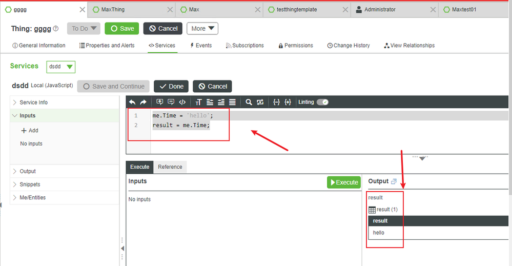

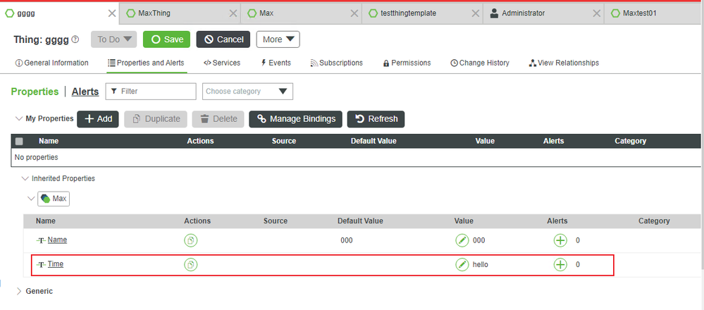

Hello @sabharees
I do the test for you in TWX 9.0.
me.Time = 'hello';
result = me.Time;
BR,
Max
