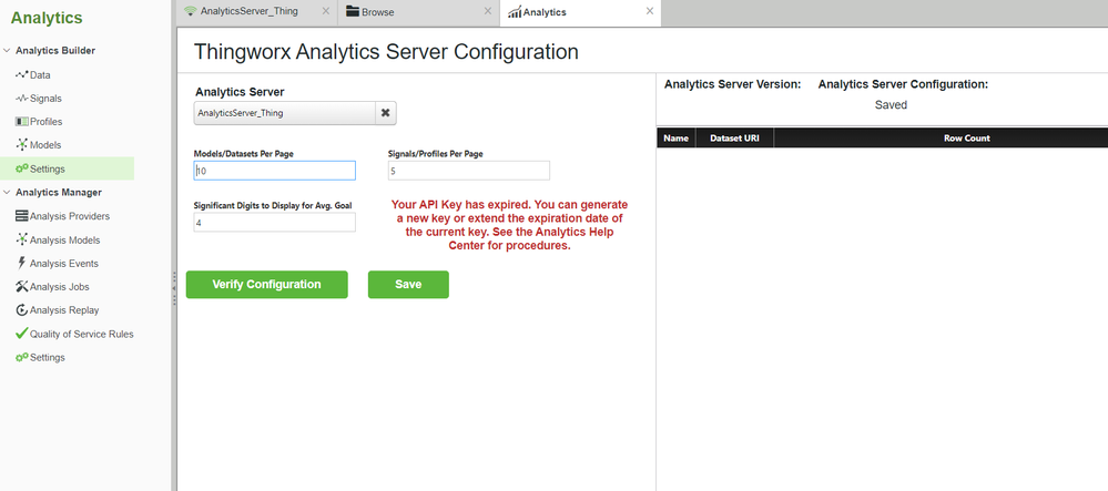

I started a new trial and I am getting this message when I try to view anything in analytics section...
Your API Key has expired. You can generate a new key or extend the expiration date of the current key. See the Analytics Help Center for procedures.
I checked all my app keys and they are fine so this is obviously something behind the scenes. I found a link to change the expiration for an installed version but I am on the hosted trial. How can I fix this for the trial? Thanks

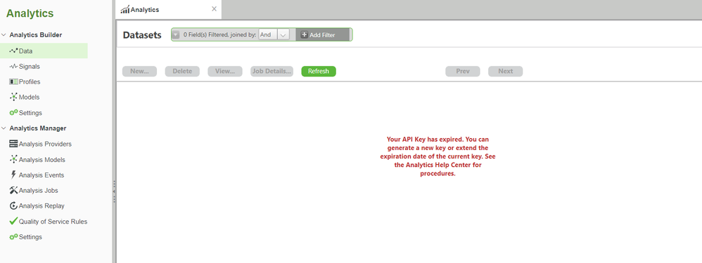

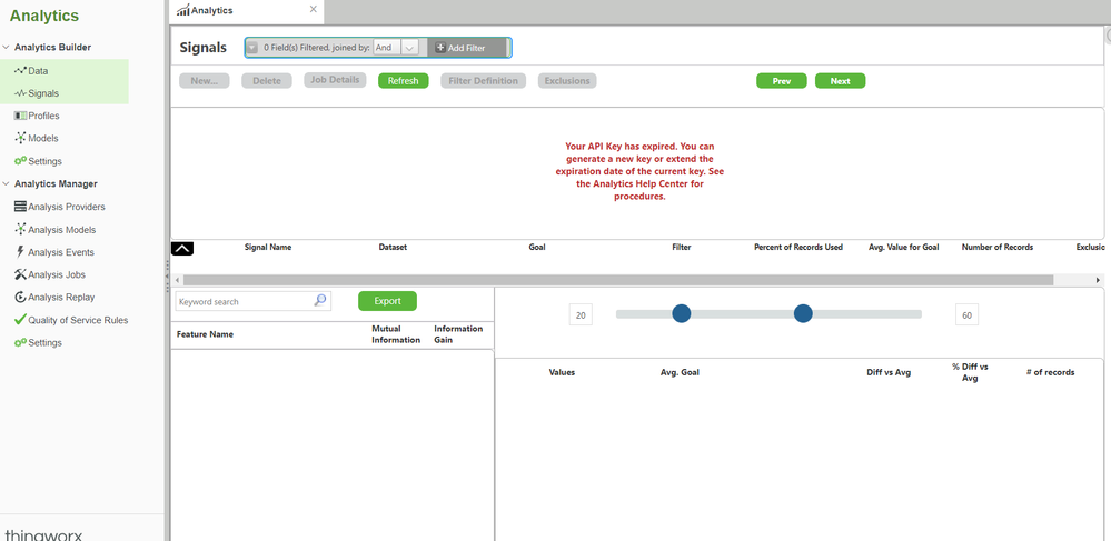

I copy and pasted exactly what it says in the original post. It is anything to do with the analytics builder. I started this trial about 6 days ago. It was working fine when I started it but now I cannot do anything in analytics portion.
@justinoberle ,
While I understand that is the message you are seeing, it does not apply to Analytics Builder as that API key is separate from the application use case you are operating.
Can you verify that the Gateway/Adapter in Builder Settings is connected?

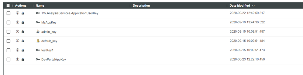

Also, can you provide a screenshots of your Application Keys?

Here are some screen shots. All of the application keys are still active and have not expired. I made sure of this. Also, every tab under "Analytics Builder" gives this red message.

I think the AnalyticsServer_Thing is the issue, however, it is connected. here is an image.
@justinoberle ,
As this appears to be an issue with the VM/Infrastructure, I have referred this issue to the DevZone team to triage further as you and I do not have access to the image directly.
If you are on a short time line, I would recommend creating a new instance, or download the trial edition local install to continue your evaluation.
