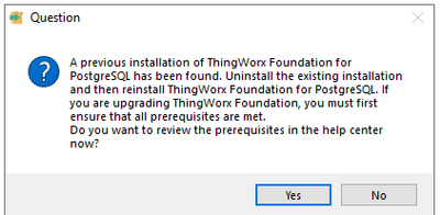

I hope to seek for some advice on upgrading the TWX version from 9.1.0 to 9.2.3 with Thingworx foundation for postgresql window installer. I read that i am able to use the Thingworx foundation to upgrade.
My current version of the TWX is as per followed:
PostgreSql: 12.4
Apache Tomcat: 9.037
jre: 11.0.9
I checked with the PTC Release advisor that to have 9.2.3 pre-requisition is:
PostgreSql: 13
Apache Tomcat:9:052.
I had using the Thingworx Foundation installer to attempt to install...it immediate show the following message.
can anyone advise a proper steps to upgrade without have to affect my projects files in my existing Twx.?
if i uninstall the existing version it will be wipe off, so it like a fresh installation, fresh database, everything new.
is there anyway to upgrade "smoothly".....

I would use the manual upgrade procedure since you're having issues with the installer.  Here's the link to the instructions.
If you still have issues, please let us know.  We'll be happy to open a case on your behalf for a Support Services engineer to assist with the upgrade.

Yes, i had attempted, difference scenario:
Scenario1:
  1. I meet the basic hardware requirement and guide mentioned.
  2. I did not update the Java as my 9.1.0 is using Java 11, referencing to below
    Article - CS348198
  4. I did not upgrade the postgreSQL
  6. i stop all services, and i run the installation, the message appear.
Scenario 2:
  1. I uninstall Tomcat.
  2. I run the TWX foundation installer, the message appear
Scenario 3:
  1. I upgrade the PostgreSQL to version 13.
  2. I run the TWX foundation installer, the message appear.
Scenario 4.
  2. I uninstall Tomcat
  3. I run the TWX foundation installer, the message appear.
For Scenario 2,3 & 4, i stopped all the tomcat services. before i run the installer.
If i uninstall the TWX foundation for 9.1.0, that is like a fresh installation, as i need to configure all over again.
Is there and documentation on what will be the appropriate step to take..?
Hope someone can advise me.
Thank you!

Thank you Sharon,
Using the manual installation is more effective for me. just need to use the update 9.1 to 9.2, and was upgraded!
Thank you
