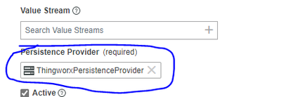

Hi @Lo_ry96,
I have done this before for another use case. Below are the steps:
  1. Add Influx as the Secondary Persistence Provider in Thingworx
  2. Create a value stream, while the creation of a Value stream selects the Secondary Persistence Provider instead of "ThingworxPersistenceProvider":
  3. Then assign the value stream you have created to a Thing
  4. Create the Properties and check the log while creating the Property
  5. Once the Log is checked, when data comes to the property it gets stored in the Influx DB
