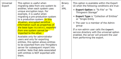

I have been trying to export the Users for taking back up from ThingWorx, for which I have written a service using "SourceControlEntities" and it is working fine.
But while Export, the PASSWORD of user's gets reset.
Due to which, I can not login again to Thingworx with those Users including Administrator.
Please help me to suggest a way to Export the Users via Service.
Thanks.

I can do Export Using the menu given on top of Composer.
If I choose -> Export to File,
then when I import the Users to Thingworx -> Import from file,
the passwords gets also imports successfully.
As it uses some hash mechanism in background.
I want to do this by a service so that the service can get called from scheduler on daily basis to export Users.
When I do Export from service, I write the code using "SourceControlEntities" from which password doesn't get export to xml.
Hence while Importing, password doesn't get import as I mentioned earlier.
I explored the documents you sent me, didn't able to extract a solution from that.
As in Universal Export, Password can't be exported.
But there must be a way so that I can export users from service

Turn on developer tools as you execute the export, I believe you'll see some call to /exporter
You might be able to execute that as well using a service possibly using contentloader functions.
