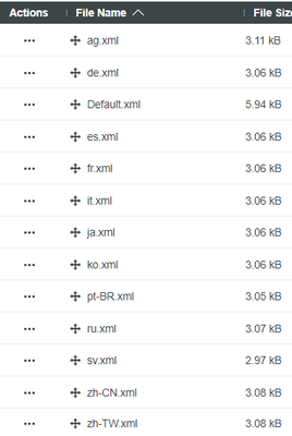

I did some modifications to not have to use the GIT template and instead use input parameters for the local FileRepo and FileRepoPath.
This then as you say export just the tokens with whatever prefix has been input.
However you still get all of the other language tables in the repository as well;
I suppose if you really wanted to you could change the code so as to not export any tables that do not contain your prefix.
Then I tried using the import from source control entities;
Which seems to have worked fine as my token was imported successfully.
So I guess it would probably work with having the "LocalizationTables" folder in your GIT if you wanted to import everything at once.
Thank you for your help.
Jens
