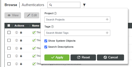

Most of the Thingworx Authenticators are system objects. When you browse for authenticators, make sure to click on the filter icon and select "Show System Objects" checkbox.

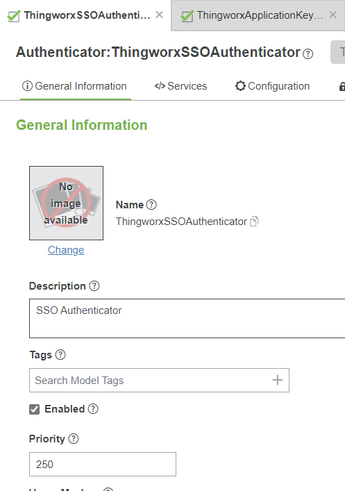

You will also need to go to the "ThingworxSSOAuthenticator", edit it and change the priority to 250. Since, this is not a system object, editing it and changing priority or enable/disable is straight forward.

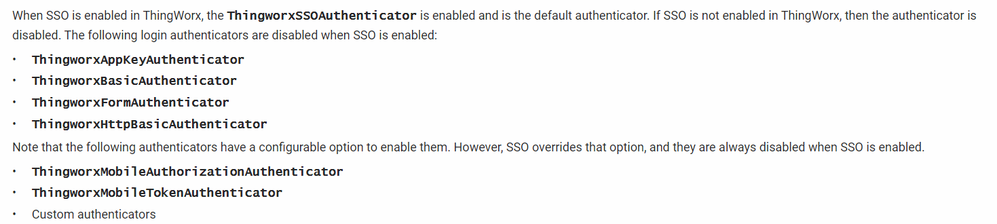

If all the settings are in place as mentioned in the sso configuration guide and help settings then it may be a case where the App Key Authenticator is disabled.
You can reference the TwxSSOAuthenticator help page. Pasting an extract snapshot here:
Enable the "ThingworxApplicationKeyAuthenticator". And also try to keep the priority on this as a smaller integer as compared to the SSO Authenticator.

Open 'ThingworxSSOAuthenticator' and set priority to 250
You can click on 'Show System Objects' to see the default authenticators
By default 'ThingworxApplicationKeyAuthenticator' priority is set to 200, so ThingworxSSOAuthenticator should be higher than AppKey authenticator.

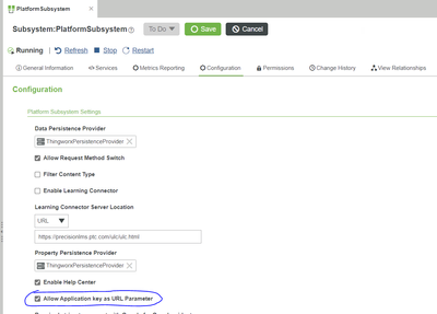

Check whether Allow Application Key as URL Parameter is enabled in Platform Subsytem
Please refer to this article for more information - Article - CS227935 - Accessing Mashups using Application Key (appKey) Authentication in ThingWorx (ptc.com)
/VR
SL_10617171
(To:Velkumar)
hi @Velkumar ,
Yep, it sure is:

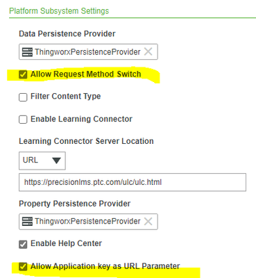

@SL_10617171
Platform Subsystem configuration looks good.
Try to use 2nd URL format and also check appKey expiry date.
