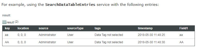

Based on help center introduction regarding Data Table Services, provide below demo for understanding the meaning of the parameters (even though below table is the output of another service):
Below is my demo fragment for values:
var values = Things["VendingMachineInventoryTable"].CreateValues(); //or    var values=me.CreateValues();
values.productID = ProductID; //STRING
values.currentInvQty = Current; //NUMBER
values.vendPosition = Position; //NUMBER [Primary Key]
values.positionCapacity = Capacity; //NUMBER
values.productPrice = Price; //NUMBER
