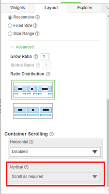

When a Value display widget is paced Responsive container, Scroll bars were seen. When checked in the Layout of the Container, Container Scrolling for Vertical is Disabled, why ?

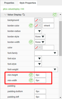

The Scroll bar issue has been Fixed. Whenever I place a Value Display widget in a Responsive Container, I need to go Style Properties--> Base ---> Value Display and Make min-height and min-width to 0px. The same must be done on the Hover, Focus, and Pressed to make Value Display total Responsive per the Screen's Resolution.
By this we can Avoid the Scroll bars in the Value Display widget and most of Responsive Widgets.
