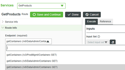

Version: Windchill 12.1
Use Case: Rest API Endpoint not visible
Description:

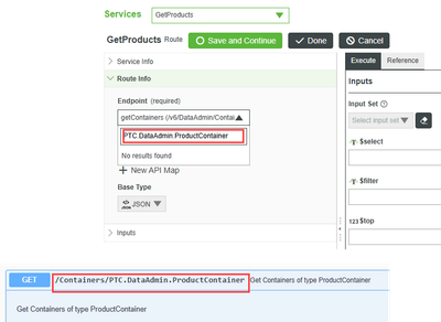

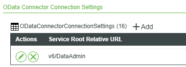

I have the v6/DataAdmin in OData Connector Connection Settings on the OdataConnector. I am able to see the getContainers API but I need to get list of Products, so I'm looking for this end point but it is not visible in thingworx connector.
/Windchill/servlet/odata/v6/DataAdmin/Containers/PTC.DataAdmin.ProductContainer

3. Connector Caching Issue in ThingWorx
  • The ThingWorx OData connector sometimes does not refresh available endpoints even when Windchill is correctly configured.
Fix:
  • In ThingWorx:
    1. Go to your OData Connector Thing.
    2. Delete and re-add the Service Root (v6/DataAdmin).
    3. Or restart the ThingWorx server if that doesn't work.
This forces a fresh discovery of available endpoints.
4. Wrong or Incomplete Endpoint Mapping
  • If the GetProducts Service in your screenshot is manually configured, make sure the correct endpoint path is typed fully:
    swift
  • You cannot just browse it via a dropdown if it's not auto-discovered—manual entry is required.
