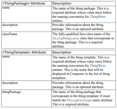

@seanccc
I found some more information around ThingPackage in ThingWorx Extension Development Guide,
Each Java-based thing template must have two entries in the metadata.xml
file:
• A <ThingPackage> element under the
<Entities><ThingPackages> element, which specifies the class name
of the thing template
• A <ThingTemplate> element under the
<Entities><ThingTemplates> element, which refers to the name of
the thing package.
Sachin
