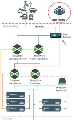

Hello @seanccc
I don't think it's going to be a perfect thread allocation.
Refer to figure below. If a user logs in to the system, the load balancer will determine which system is currently better suited to respond to the request, but only one system will handle it, other systems do not share the tasks that need to be handled.
https://supportdev.ptc.com/help/thingworx/platform/r9/en/#page/ThingWorx%2FHelp%2FThingWorxHighAvailability%2FOverviewOfThingworxHighAvailability.html%23
BR,
Max

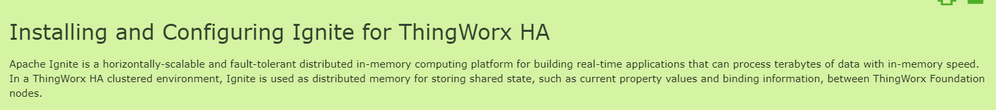

Hello @seanccc
I found that Apache Ignite has been added since 9.0, which can realize active active load balance, so HA systems can handle events together.
https://support.ptc.com/help/thingworx/platform/r9/en/index.html#page/ThingWorx%2FHelp%2FThingWorxHighAvailability%2Finstallingandconfiguringigniteforthingworxha.html%23
Hope this information is useful to you.
BR,
Max
@Rocket_Max ,
The page only mentions Ignite is used in ThingWorx 9,  but doesn't explain how and when the 2nd server will process a event which is not raised from itself,  and it doesn't describes how active-active cluster affects the configuration of EventProcessingSubsystem,  for example,  if the max count of thread is 500 in EventProcessingSubsystem,  how the 500 threads are allocated between 2 servers , or each server can has 500 threads ?
Could you provide more document about it ?
Sean
Sean

tcoufal
(To:seanccc)
Because it does not.
Ignite has nothing to do with application. It is a "simple" rather "simply" distributed data store.
Event handling is part of the application.
Thingworx uses context-stack, so it knows which precess invoked another.
event handler is executed in eventProcessingSubsystem thread(s) on which the originated request landed.

"the load balancer will determine which system is currently better suited to respond to the request"
Be careful when you write things like that, because it depends, and by default it is not true.
In your haproxy config example you are using "roundrobin" as the loadbalancing algorithm. So it does not consider any metric other that if the backend is simply "up" (health check on /Thingworx/health or ready only returns status code).
No weighted roundrobin, no leastconn. No server is better suited than the other in this scenario. Unless you consider dead backend as not suited....
In nGINX is ip_hash used for session stickiness, that would be a big problem when you would use some reverse-proxy systems, since it would cause all sessions to be stuck to the same backend.  Again basic algo is Roundrobin.
The HA after TWX 9.0 uses ignite, and all nodes can share the tasks freely, it's like taking tasks from the same pool, not simply divide the task to 2 pools.
The HA before 9.0, uses active/ standby, all tasks is done by the primary server.
