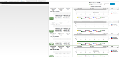

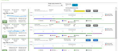

anomalous state is not showing my anomaly dashboard ,what could be the possible error

hey @nsampat that's how my dashboard looks now i bound the tags but i dont know how to pull the values in or what is wrong these are basically temperature torque, pressure readings

Unfortunately, we do not assist with mashup creation or mashup troubleshooting for Anomaly Detection. The dashboard you are using is a demo provided as is. I am not seeing any data shown in the screenshot provided, so its hard to say what the issue could be. Do you see any errors in the ThingWorx log (Application Log, communication Log, Error Log, Script Log, etc) ?
Can you provide if it worked with the demo test setup indicated in the article above? If it doesn't, I would recommend going through the validation article to better understand how everything connects and works.
I can only suggest that you review your tag mapping, and make sure data is being fed to those Things.
