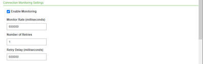

yes i already modify database thing timeout already please check below Screenshot

Hi @Ru ,
Could you please confirm if you tried using the SQL Thing approach I described? Or you are still using the Database Thing?
It's not clear from your reply if you implemented the changes I suggested.
