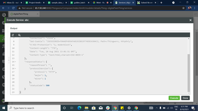

@PaiChung as you say i have to call postjson() service from snippet and have called it but it's giving me 500 internal server error......i converted infotable data into json format by using tojson() snippet and when i am set output as json base type it's giving me an output in infotable format but when i am setting an output in text base type then it's giving me an output in json format......now i want data in json format after converting it into json format......from all these i want to create get api for postman.....so please suggest the solution on this asap....below are some attachments for your better understandings...
infotable data which i want to convert into json format
Postjson() service error

@PaiChung as you say i would have use postjson.....i used it and set output base type as json but it's giving me an error 500 internal server....... so i want to ask you that how i resolve this error?
below is my postjson() code and it's output:-

Please check the Script and Application Log it may have more information on the error.
i can't see any error in application log
Unfortunately Error 500 is a bit hard to interpret without any extra information.
You can try simplifying your service perhaps and go step by step until it breaks.
