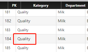

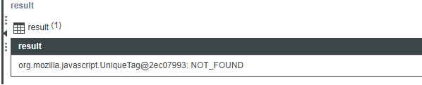

here is a question for using query filter. when I custom the service, there is an error appearing in the result. Could Someone can help me to fix this problem and what is the output should I choose. Now I chose "STRING"

I see that you are trying to query a DataShape type entity. I would try creating an infotable from the Datashape.
var params = {
    infoTableName : "InfoTable",
    dataShapeName : "InputYourDatashapeNameHere"
// CreateInfoTableFromDataShape(infoTableName:STRING("InfoTable"), dataShapeName:STRING):INFOTABLE(TestDS)
var inputforFilter = Resources["InfoTableFunctions"].CreateInfoTableFromDataShape(params);
Populate the created Infotable with the values you would like to filter/query upon. Use the EQFilter to query the infotable as below.
var filterparams = {
	fieldName: "Kategory" /* STRING */,
	isCaseSensitive: false /* BOOLEAN */,
	t: inputforFilter /* INFOTABLE */,
	value: "Quality" /* STRING */
// result: INFOTABLE
var result = Resources["InfoTableFunctions"].EQFilter(filterparams);
The output of the service should be an infotable with the same datashape that you are querying on. Please let me know if you run into any issues.
