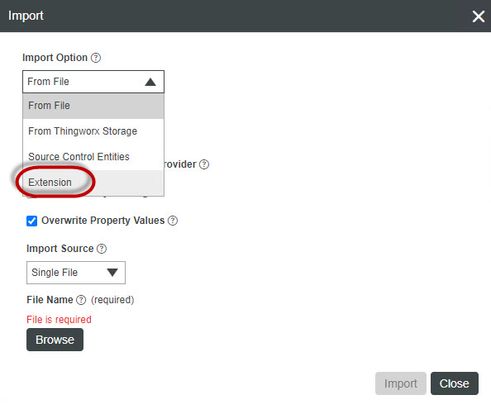

I found this error. Invalid request: com.thingworx.common.exceptions.InvalidRequestException: Entity Import Not Supported for File Type: .zip
- Mark as New
- Bookmark
- Subscribe
- Mute
- Subscribe to RSS Feed
- Permalink
- Notify Moderator
Please choose Extension as the import Option
