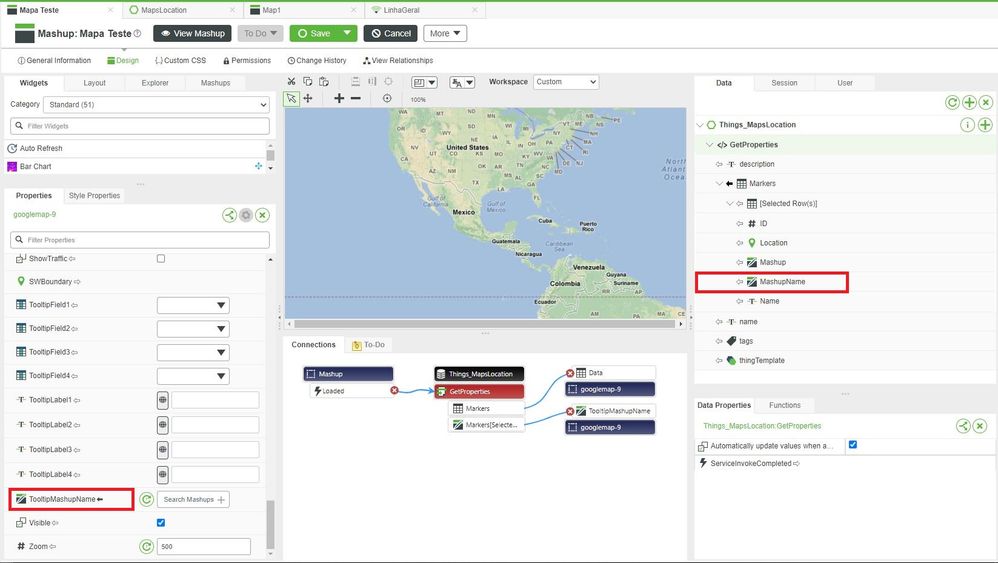

Absolutely. Check the Google Map documentation available here: http://support.ptc.com/help/thingworx_hc/thingworx_8_hc/en/#page/ThingWorx%2FHelp%2FMashup_Builder%2FWidgets%2FGoogleMapWidget.html%23
The property you want is the TooltipMashupName.

Once you click on the markers in the map, the SelectedRow will change on the associated map source infotable (the Data property).
1. You can design a service which takes as an input parameter the Marker name (or whatever field uniquely identifies your marker) and retrieve the Mashup name that then you bind to the TooltipMashupName of that Google Map widget
or
2. You can just add the Mashup name as a field of that Data that is associated to the GoogleMap widget, and then bind that field from the SelectedRows collection to the same property I mentioned above.

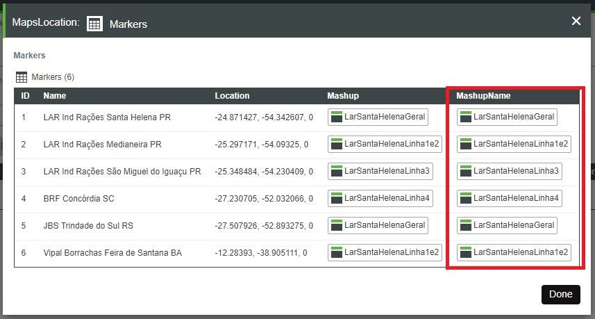

I have done the follow:
1 - I have created a field base type "MashupName" on my InfoTable:
2 - I have used the service "GetProperties" and binded the "MashupName" from SelectedRow(s) to the property "TooltipMashupName"
Is it correct?
