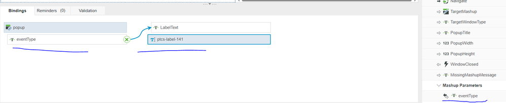

In Popup Mashup, create a mashup parameter to pass data from Popup to Main mashup. And bind dropdown selected text value to mashup parameter
In Main Mashup, map the popup mashup parameter to change the gauge value. In my case, I have mapped it to the Label

Hello@Velkumar I m trying same as you but my data is not passing from popup mashup (from dropdown) to main mashup for gauge widget.
Hi @Pratik_Aswale
If possible could you please share mashup here
/VR
@Velkumar Actually, I missed the mashup load event to load data. Now its working fine.
